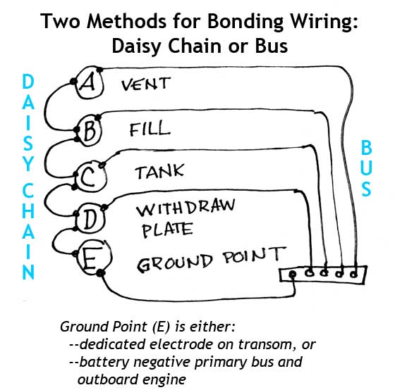

Postby jimh » Tue May 22, 2018 1:44 pm
Below is a sketch showing two methods of bonding wiring. One method is to daisy-chain from device to device; shown on the left side. A second method is to use dedicated bonding conductors from each device to a central bonding bus, with the bonding bus then being wired to the ground reference point; this is shown on the right. Use one of the two methods, but do not combine them.
Two methods of wiring a bonding system: daisy-chain or bus. Pick one method and don't combine them.
The above illustration shows two methods of wiring the bonding circuit. The bonding circuit in the "Daisy Chain" configuration as seen on older Boston Whaler boats is NOT bonded to the battery negative or engine chassis, and is left isolated, connected to the overboard electrode "E".
In the "Bus" method, the bonding circuit has separate conductors to each element of the fuel system, bonding them to the common point "E" which is typically the boat's primary battery negative bus which includes the engine chassis connections.
The BUS method is probably preferred but it uses a lot more wire. In the DAISY CHAIN method a loss of one contact could compromise the whole system by isolating more than one device.
Maintaining the integrity of the bonding system is very important. The action of flowing gasoline through the hose from filler inlet to tank can create an electrical charge. It is also imperative that the metal of the filler inlet not be raised above ground potential. When the filler hose is brought from the pump to the filler inlet, both the fitting on the hose and the filler inlet should be at the same potential--ground or zero volts--so there is no sparking.
