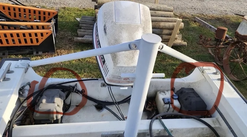

The batteries on my [1991 GUARDIAN 19] boat are in the engine splash well as seen below in Figure 1.
Fig. 1. Engine splash well with two batteries, slightly obscured by added colored circles.
Image 45.jpeg (191.37 KiB) Viewed 19579 times
I am planning to move the batteries into the center console, and also to add a third battery for house use.
Q1: is there any reason not to move the two batteries to a more protected location?

pcloward wrote:Is there any reason not to move the two batteries to a more protected location?
Boston Whaler designed the boat to have the batteries located in the engine splash well, and provided reinforcement material below the laminate of the deck to support the weight of the batteries. Boston Whaler sold many thousands and thousands of boats like yours with the batteries located in the engine splash well.
The idea that you will be making an improvement in the boat by moving the batteries out of the engine splash well and placing them inside the center console is not particularly a sure bet. There are many problems in your plan. I will mention just a few of them.
First, and perhaps foremost, increasing the distance between the engine starting battery and the engine starting motor on the engine that the battery is supposed to crank over is a terrible idea on the electrical perspective. Anyone who understands electrical current flow and the effect of resistance in the wires in the circuit will immediately see the problem. If you need a more thorough explanation of the electrical problem that will be created if you add 10 or 15 feet to the length of the cables, let me know, and I will give you a more detailed explanation. But the simple answer: making the wires longer is a very, very bad idea.
Second, the transom location will generally give the batteries the most comfortable ride, as compared to other locations, there will be less pounding and slamming of the hull in waves at the very stern than anywhere else on the boat. This will give the batteries a longer service life.
Third, the center console was never designed to support the weight of one battery, let alone support the weight of three batteries. Nor was the deck below the center console designed for such a concentration of weight to placed there. Nor will there be room for three large batteries in the center console. Nor will it be easy to service or inspect or remove the batteries from the center console. And the weight off all those batteries when the hull is slamming into waves will be a huge and unanticipated load on the deck at that location.
As long as the batteries are in proper battery boxes, and the battery boxes are secured to the deck with proper straps, and the straps are secured to the deck with proper Footman's Loop fittings, there is really little concern about the location being in the engine splash well.
Even if the boat were to be overtaken at the transom by a huge following sea, the conductivity of freshwater is very small, and the conductivity of saltwater, while much higher than fresh water, should not immediate cause a short circuit at the battery terminals. To prevent any short circuit, you can spray the connection between the cables and the battery terminals with a coating of insulating wax, such as BOESHIELD T9.

In Figure 1 I see that the two battery boxes are different colors. The OEM battery box from Boston Whaler was molded in a color called Desert Tan to match the hull gel coat.

Moving the batteries to the console is a good idea. The weight distribution change will be beneficial.
You should use 4-AWG marine battery wire. For the run from the console to the engine, use one [continuous] wire, no splices. Remove the four-foot battery wire tail from the engine and run the new negative from the terminal post under the engine cowling to the negative post of the starting battery in the console and the new positive wore to the master battery switch output terminal.
Cut openings in the console floor to allow the battery boxes to sit on the deck. The console floor is not strong enough to support the weight of batteries and consumes valuable space. Recessing the batteries minimizes the lost space in the console.
The need for three batteries appears onerous and unnecessary. Please describe the electrical load planned that requires three batteries.

Phil T wrote:Moving the batteries to the console is a good idea. The weight distribution change will be beneficial.
As you might expect from me earlier remarks, I am not in agreement.
Regarding moving battery weight out of the transom, in this case the boat is likely to be maintained as a single-engine-powered boat. The GUARDIAN 19 hull could easily accommodate twin engines, so the weight of just one engine and two batteries in the stern is not likely to reduce freeboard at the transom.
Moving the batteries to the center console location will give the batteries a much rougher ride when the boat is encountering larger seas. Keeping weight of of the ends of a boat is a good plane for a displacement hull like a sailboat, but I don't think this rule applies to smaller outboard boats with planing hulls.

Many classic Boston Whaler models and CPD and BCPD have a waterline above the transom thru-hull drains at rest. Helping offset this is worth the work. Gaining an inch or more of transom out of the water is helpful.
Having your battery and cables subjected to saltwater is just helping corrosion. Some owners ship saltwater over their transoms frequently due to water conditions.
Relocating the battery, oil reservoir, and the accompanying cables gives the transom a cleaner look, and it allows passengers to enter or exit via the transom with more ease.

If the engine splash well drains end up under water, there could be a rationale to get weight out of the transom.
Engine electrical cables in the rigging tunnel will also be likely to be exposed to water.
On my 20-foot classic OUTRAGE hull I kept the engine splash well drains plugged, and I installed a centrifugal pump to lift water out of the splash well and over the transom. The boat had twin engines which were mounted on 10-inch set back brackets, the oil tanks were internal to the engines, there were two batteries in the splash well, an auxiliary fuel tank in the stern, a large cooler in the stern, and a second cooler in the splash well. Water came over the transom only one time, and that occurred when we were in a very narrow passage with a tidal current of six knots or more pushing us ahead, there were very large standing waves, and the boat was making sternway in order to not get swept into a whirlpool. Water came over the transom, the pump came on, and the transom splash well was soon dry.
