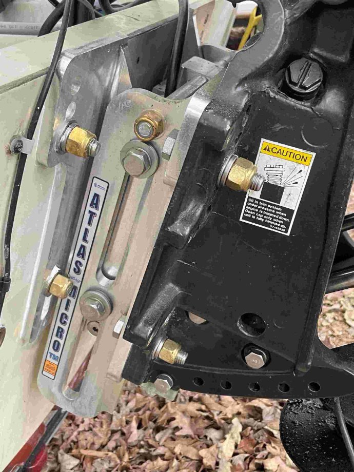

The mounting instructions that came with this jack plate were rather nonspecific.
"Using flat washers and lock washers, attach the jack plate to the transom with the bolts that came with the engine ... use four stainless steel ½ inch-13 3-inch bolts to secure the engine to the jack plate."
There was no mention of how tight to secure the bolts or whether sealant is recommended. Searching online, I found a wide range of recommendations for this step. The photo of the jack plate in the Atlas info sheet that accompanied my unit is indicative of this variety, as shown in Figure 10.
Figure 10. Photo from info sheet that accompanied the Atlas Micro Jacker. Note that one transom mounting bolt has a brass lock nut (arrow); the other mounting bolts have conventional (non-locking) stainless steel nuts with split-ring lock washers. The bolts used to mount the motor to the jack plate appear to be fully threaded (sometimes referred to as “tap bolts”); these have a lower strength than hex head bolts which are only partially threaded.
Atlas jack plate bolts.jpg (113.4 KiB) Viewed 10417 times
I thought it might be prudent to collect more information before proceeding with the final installation; I started by searching the continuousWave.com Web site. I couldn’t find anything regarding bolt torques for jack plate installs, but I did find a discussion thread about engine mounting bolt torque (https://continuouswave.com/forum/viewto ... 890#p29890). The answers there ranged from “Snug. Do not overtighten, just tight” to 50 ft-lbs, with 40 ft-lbs cited from an Evinrude E-TEC manual. Next, I contacted Bob’s Machine Shop since I had bought their bolt kit. Their initial reply was unsatisfying:
Figure 11.
Mercury torque spec decal.jpg (50.86 KiB) Viewed 10417 times

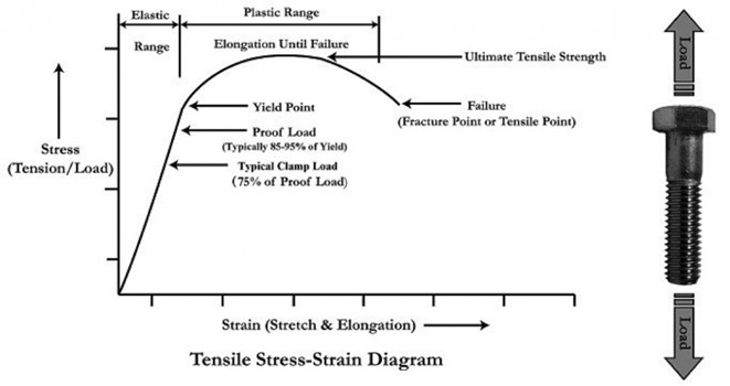

I must admit to having fallen down a rabbit hole regarding the tightening of these bolts. I found that one of the best sources for publicly available information about bolt tightening is the National Aeronautical and Space Administration (NASA), who apparently has hired engineers that sit around all day thinking about the best way to tighten bolts. This is probably money well-spent, since NASA has had some painful experiences involving fasteners. For example, a science experiment on the space shuttle Atlantis that cost $128 million to set up was ruined by an improperly installed ¼ inch bolt (see here for the story: https://www.nytimes.com/1992/08/29/us/tiny-bolt-blamed-in-shuttle-failure.html#:~:text=A%20tiny%20bolt%20apparently%20caused,the%20space%20agency%20said%20today. NASA sent the experiment up again on a later space shuttle, and it failed due to corrosion of a cable. I guess those NASA engineers hadn’t thought about the effects of salty Florida air.) And there is the sad story of the space shuttle flight that was delayed because a titanium nut on the hatch door handle stripped. A maintenance man called to fix it was delayed because of security problems and a dead battery on one his tools, and he had to use a hack saw to cut off the nut (story here: https://www.newspapers.com/clip/27296929/broken-door-handle-delays-challenger/). By then, it was getting late in the day, so the flight was postponed to the next day (at a cost of about $1.2 million). Unfortunately, a cold front blew through overnight, some rubber O-rings on the rocket got too stiff, and ... you probably know the rest of the story about the Challenger flight. Much of what is discussed below came from NASA’s Fastener Design Manual, publication 1228, published in 1990 (available here: https://mae.ufl.edu/designlab/Lab%20Assignments/Fastener%20Design%20Manual%20(NASA).pdf).
I think that part of the reason for the range of torque values recommended for outboard motor and jack plate bolts is because the bolt is part of a fastener system comprising the bolt, nut, washers, and the objects being fastened. The force that a fastener system uses to secure two objects is obtained by stretching the bolt shaft (this force is termed the axial tension or tightening force). Bolts are elastic, but if the axial tension is excessive, the bolt loses its elasticity and becomes permanently stretched; if tightening continues, the bolt will break. It’s worthwhile to review some definitions about bolt tightening.
Ultimate tensile strength – the maximum force a fastener can maintain before fracture.
Yield strength – The axial tension at which a bolt loses its elasticity and becomes permanently stretched.
Proof load – The maximal axial tension at which the bolt maintains its elasticity. This is typically 85-90% of the yield strength.
Typical clamp load – The axial tension recommended for a fastener. This is usually about 50%-75% of the proof load. This number is generally conservative, in part because of the uncertainty of determining axial tension from a torque value. Torque wrench accuracy can be as low as +/- 25%; NASA requires that all torque wrenches be calibrated on initial use, every 30 days, or whenever the wrench is dropped on the floor!
Here is a graph that illustrates these terms:
Relationship between axial tension and strain on a bolt.
Bolt tightening graph.jpg (32.9 KiB) Viewed 9956 times
Source: SmartBolts. Fundamentals of Basic Bolting. http://www.smartbolts.com/fundamentals/#:~:text=Proof%20load%20is%20defined%20as,95%25%20of%20the%20yield%20strength.
Unfortunately, the axial tension on a bolt cannot be easily measured, so we are left with determining the force required to turn a nut on the bolt. This is the torque value, and only about 10% of the torque is due to the axial tension on the bolt; the rest is due to friction in the fastener system. The axial tension can be estimated from the bolt torque using some standard engineering formulas you can review here:
https://www.engineeringtoolbox.com/bolt-torque-load-calculator-d_2065.html
A given torque on a bolt will yield different axial tensions depending on the bolt material, the thread design, the design of the nut and washer, whether the bolt threads are lubricated, and even whether it is the bolt head or the nut is being turned. Bolt torque charts usually list values for dry bolts with the nut being turned, but some charts include alternate (and often much lower) recommended torques for lubricated bolts. Basically, if you lubricate a bolt before tightening it but you use the same torque specified for a dry bolt, you risk damaging the fastener.
Here are a few other things I learned from reviewing the NASA manual:
- Most locknuts (including Nyloc nuts) don’t really help maintain bolt tension; they are loss retention devices that keep the nut from falling off the bolt.
- Split ring lock washers are essentially worthless for maintaining bolt tension. (Yes, I was surprised, too. Watch this video: https://www.boltscience.com/pages/helicalspringwashers.htm)
- For multiple fasteners, the bolts should be tightened sequentially in a crisscross pattern.
- There should be two threads protruding past the end of the nut.
- Bolts should be re-torqued after installation to account for relaxation of the fastener system.
- NASA recommends against using jam nuts because it is difficult to obtain reliable torque values for the fasteners. They do lock the nuts in place effectively, though, which is probably why Yamaha recommends them.
The charts I pulled up online indicated that the appropriate torque for the bolts I had received from Bob’s Machine was about 55 ft-lbs (with dry threads), but I wasn’t quite ready to give up on finding out why Mercury had such a high torque (90 ft-lbs) when this type of bolt was used to mount the engine to a jack plate. I found a Mercury online customer service information site that lets you send them a message if you enter your Mercury outboard serial number, so I sent them this:

Final installation of jack plate on my Montauk 17
My 3½ inch bolts turned out to be a little short, but the threads do engage the nylon ring of the locknut, so I’m going to leave them as is for now. Torquing to 55 ft-lbs seemed quite snug, but there was no cracking of the fiberglass on the transom. I couldn’t get the socket of my torque wrench around the nut on the lower transom bolts, so I was forced to torque those fasteners by turning the bolt heads.
Next step: Testing the unit on the water.
