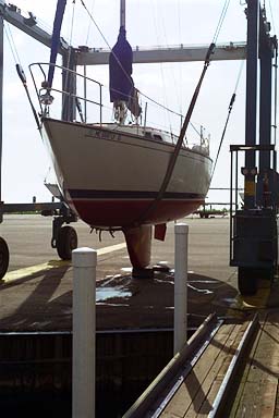

When you are up in the North Channel, everything is a little rustic, and that includes the boatyard. Their haul out was a smaller version of a Travel-Lift, and the width of the haul out slip was just barely wide enough to accommodate our 10' 3" beam. It looked like we would have about six inches or less on each side. To make things interesting, the boat had to be backed in to the slip. This was required because we would have to remove the backstay in order to clear the frame of the lift when the boat was raised out of the water.
We were already a little frazzled from the whole experience of grounding, and, you might say, our confidence at boat handling was at a new all-time low water mark. (Pun intended!) Unless you happen to have a very unusual boat, you know that most single-screw inboard boats back up in a random manner, pretty much independent of rudder action, especially at slow speeds in shallow water. The crew and I were standing around, hesitantly, thinking about how we were going to back our 30-foot sailboat into a slip barely wide enough to accommodate it. Getting into the slip bow-first would be hard; getting in stern-first seemed impossible.
Just about then, a salty old local wandered over to offer some advise. "Warp her in," he said. "Use ropes." Boy, the light went on! That was a great idea. We didn't need to manoeuver her in under power, we could just tie a few lines to bow and stern, and pull her into the slip backwards, under full control. Even the wind was cooperative, now, as it blew the bow off the dock, lining it up just right for a pull into the slip.
Suddenly, the difficult task of manoeuvering the boat was made simple by the use of a few lines. This is a lesson I have never forgotten. I still keep it ready to use at a moment's notice. It comes in most handily around docks, when you have to do some tight manuevers.
Once the boat was in the slip, we let the boatyard take over. They seemed to know what they were doing, so we got out of the way. We came back two days later and the boat was like new, and the yard bill very reasonable. Sometimes "rustic" pays off.

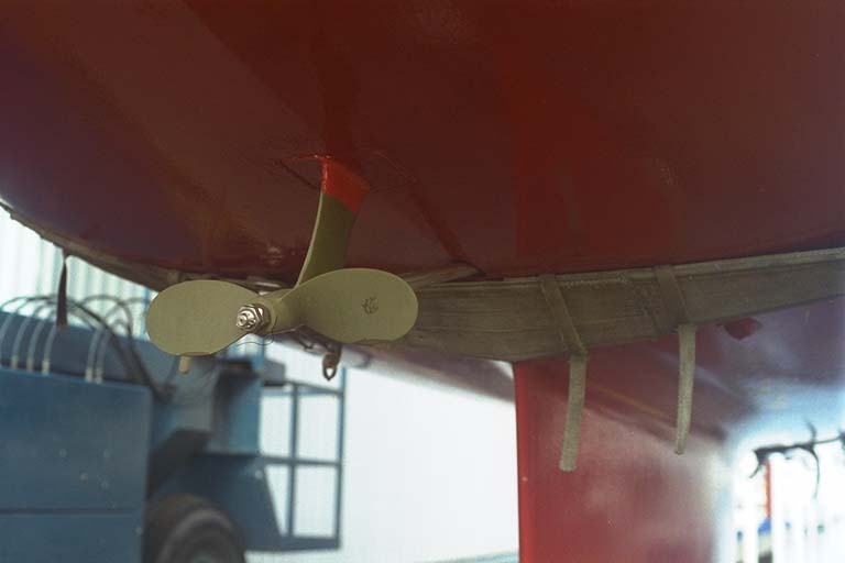

Once in the slip, the lift operator was a little hesitant to go along with the "SLING" marks that had been appended to the hull topsides by a previous hauler.
![[Photo: Prop shaft exit]](images/197.jpeg)
He didn't think the rear mark was correct, as it was very far aft, just ahead of the rudder and put the sling quite a distance from the boat's center of gravity near the keel. When moving the sling forward, however, he had to be careful not to land on the prop shaft, which would surely be deflected if forced to carry half the weight of the boat. The best spot was just aft of the keel, just forward of the prop shaft's exit from the hull.
