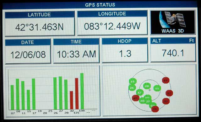

Standard Horizon CP300 GPS STATUS display
Within a few seconds of power-up from a cold start, the GPS receiver is tracking several satellites and has produced a three-dimension fix.

The above sequence of images shows the receiver's performance from a cold start, when it had been shut off for more than a week. The time to a complete WAAS precision fix mode was about three to four minutes, which represents a worst case. When re-booted (or a "hot" re-start) the receiver typically jumps to WAAS mode in less than two minutes.
This test really was a "cold start" condition. Here is the view out the window to the southwest where the WAAS satellite's look angles lay. As you can see, the receiver has to look through falling snow and plenty of trees to receive the GPS signals in this location. When on an open cockpit boat there should be little difficulty with reception.

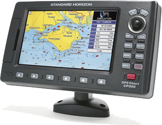

CP300 DISPLAY
Color LCD
The CP300 display unit features a bright color thin film transistor liquid crystal display. The color display has 800 horizontal and 480 vertical pixels, measures 7-inches diagonally, and is rated as "splash-proof." There is a small joystick control which is used to control the cursor position on the chart displays. The joystick also plays a major role in the user interface to the device's menu selections and other user input choices.
The size of the display is the principle feature of any chart plotter. The 7-inch screen of the CP300 is very nice, larger than most other units in this price range, and the pixel resolution is excellent. With 384,000 pixels the presentation is very fine and no pixilation is evident. On power-up the unit shows a high-resolution color photograph and graphic, which gives a hint of how video will look when viewed on the display via an external video input connector. I did not get a chance to test the display on a boat and in direct sunlight, however with the late afternoon sun coming through the windows, the display was still easily visible. With indirect lighting, I had to turn down the display backlight and contrast controls to prevent it from being too bright to comfortably view.
The joystick control is located at the top right corner of the unit. Standard-Horizon refers to this as a ShuttlePoint knob. It is easy to operate for right-handed people because the palm of the right hand can rest on the right side of the housing and the thumb can be used to manipulate the control. Operating the joystick control with the left hand is more awkward. Immediately below the joystick are the ENT (enter) and CLR (clear or escape) buttons, which will be frequently used in operating the device. Again, for a right-handed operator these buttons will be very conveniently located and can be tapped with the thumb. Below the ENT and CLR buttons are six more buttons. The MENU button is the most used of these. The MENU button invokes a page offering a choice of twelve other pages, including access to the SET UP menu. Above the ShuttlePoint knob are the ZOOM IN and ZOOM OUT buttons, which are used just about exclusively for sizing the chart display region.

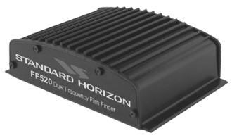

FF520 SONAR
Standard Horizon FF520 Sounder
The CP300 can be connected to the optional FF520 black box SONAR module. I did not have the FF520 available for testing. The unit does not claim to be a "digital" SONAR. Its specification state a power output of 500 or 1,000-watts and dual frequency operation at either 50-kHz or 200-kHz.

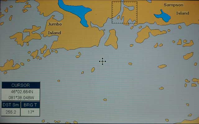

With the ZOOM set too wide, the display loses important elements of the cartography. The border drawn around the area near the top is a cue that more detail is available in that region. Note that no soundings are shown at this level.

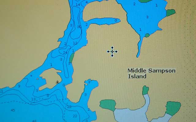

Increasing the ZOOM level one layer reveals a fantastic improvement in detail. If the user is not aware of this quirk, this enhanced detail might not be noticed. Soundings and depth contour lines suddenly appear.

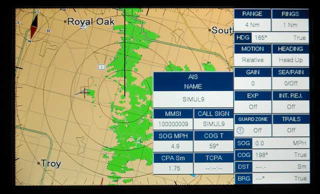

This screen shows both the RADAR and AIS Target Information from a simulator mode. The cursor has been placed over an AIS target to produce the pop-up window with additional information. The display is also overlaying the RADAR plan position indicator over the digital chart. The mode has been chosen to be heading-up.
