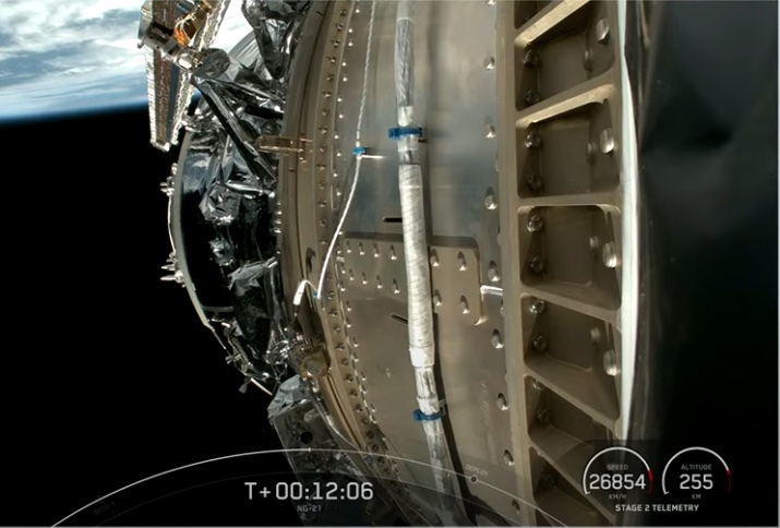

Below in Figure 1 is a screen capture from a broadcast of the launch of the Cygnus Spacecraft by SpaceX (from Saturday, August 3, 2024). The scene is just before the Cygnus will separate from the second stage of the SpaceX rocket. When I saw this I was intrigued by the use of cable ties to retain electrical cables to the body of the Falcon9 second stage, and the spacing between those cable ties.
Fig. 1. View of cable ties (blue) retaining electrical cables [silver-white) in place on the SpaceX Falcon 9 second stage, at the launcher mechanism.
The blue cable ties must be quite specially rated. The temperature range in space can be extremely wide, varying from hot in sunlight to extreme cold in darkness. The resistance to vibration must also be excellent, as I am sure the ride into space atop a Falcon9 rocket creates considerable forces.
I suspect the long span between cable ties is perhaps related to saving weight and to the simple-is-better concept.
