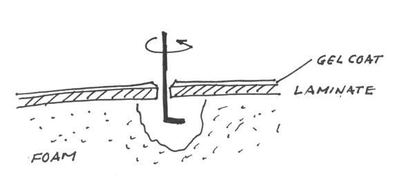

A method to create a reinforced mounting point for screw fasteners that is often used is described in another article. I quote my remarks from that article:
[To make a reinforced attachment point for a threaded fastener]...working with an L-shaped auger through a small diameter hole, dig out the foam behind the laminate surrounding the hole, creating a small pocket or void. Remove the loose foam with a vacuum through the hole. Instill a thickened resin mixture into the hole, filling the void as much as possible--try not to leave any air gaps. You may have to use a syringe to push the resin into the hole and fill the void, then quickly remote the nozzle from the hole; cover the hole with tape to prevent the resin from leaking out as it cures. Do not fill the void with pure resin, as the heat from curing may be excessive and melt more foam. This technique can create a small puck of thickened resin beneath the deck or hull. Drill a new hole into the puck area and install the fastener carefully. If you use epoxy resin you may be able to use a tap to cut threads into it, and then use a machine screw fastener
Note that if the object being fastened to the deck will completely cover the fastener hole, you can made the hole for introducing resin somewhat larger that just the fastener hole. The removed part of the deck will be covered by the component being fastened.
