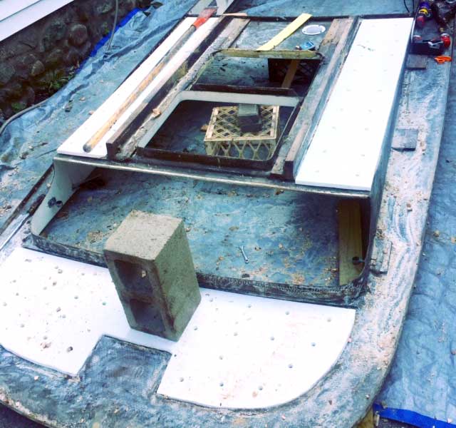

Fig. 1. New fuel tank and new deck before installation. The fuel tank has PVC sheet adhered to it instead of a foam surround.

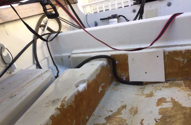

We also installed a 3/4-inch-diameter tube in [the aft end] of the fuel tank cavity [to give access for removing any water that might get in there].

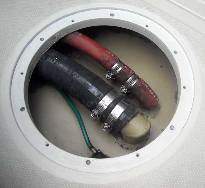

Fig. 2. Hose installed at aft end of the fuel tank cavity.

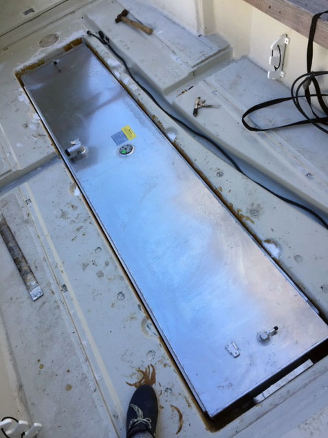

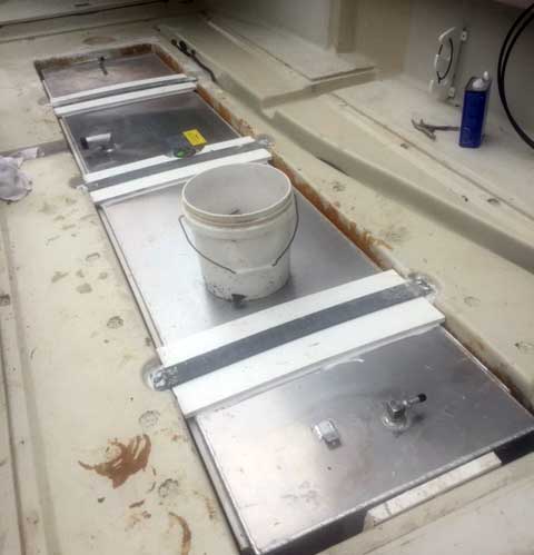

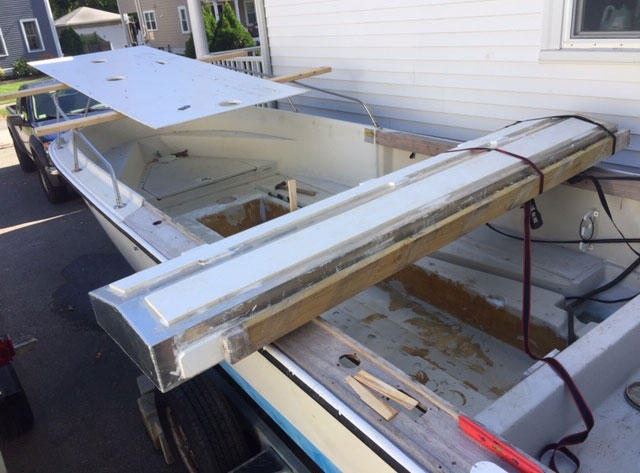

Fig. 3. Fuel tank installed into cavity.

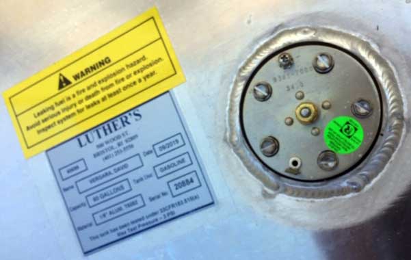

Fig. 4. Fuel tank level sender.
The new deck was made from 4 x 8-foot sheets of 3/4-inch-thick PVC sheet purchased at Home Depot. We backed this with two layer of fiberglass roving on the underside. We also used a router to make hundreds of small 1/2-inch [diameter] holes and filled them with fiberglass resin thickened with filler powder. We also scuffed the underside of the PVC sheet so the resin would stick. This new deck is rock-solid and won't ever rot.

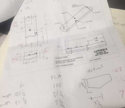

Attached is a good drawing showing details of the fuel tank fabricated for the OUTRAGE 18 by Luther's of Bristol, Rhode Island.
vergara whaler tank.pdf
Fabrication drawing of new fuel tank for OUTRAGE 18 made by Luther's.
(75.39 KiB) Downloaded 3154 times

The tank label in Figure 4 is not easily to read. You might want to retake that image with sharper focus. I believe it declares the tank to be made from aluminum.

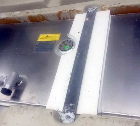

[To install] the new aluminum tank from Luther's as recommended, no foam was used, only PVC pads glued to the tank with 3M5200. The glue must form a perfect seal to keep water from getting between the pads and the metal.
I reused the [original] aluminum straps over a PVC sheet to secure the tank.
The PVC pads are also tight to the hull cavity side walls to prevent any movement of the tank.
Next step in the re-fit is to run wires, cables, fuel hoses, bonding wires, and so on. And to re-install the deck.

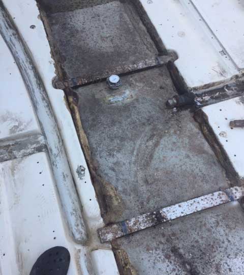

The old tank was totally rotten and corroded, even though painted with the green special paint. The foam was soaked from years of being flushed with seawater constantly as it was designed to be. The deck was also rotten from the contact with water. The design of the whole tank and deck was flawed. Every whaler of this design will have the same problem.

Fig. 5. The fuel tank installed in the tank cavity. A 3/4-inch PVC sheet material is used to fill the space between the tank and the aluminum hold-down bar.
Fig. 6. A drawing provided by Luther's of the fuel tank dimensions with some added notes in pencil.
Fig. 7. Fuel tank in place and PVC padding installed on sides of tank.

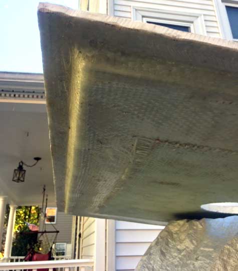

Fig. 8. PVC sheet reinforcement being prepared.
Fig. 9. Seam on new PVC reinforcement for deck. A router was used to make a 2-inch rabbit joint on both pieces, then PVC plumber's cement glued them together. The PVC is the same PVC material as plumbing pipes.
Fig. 10. View of underside of new 3/4-inch thick PVC deck with reinforcements. Around the perimeter material has been removed to restore a flush fit with the existing deck.

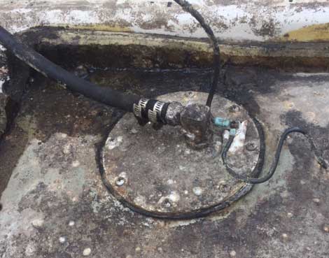

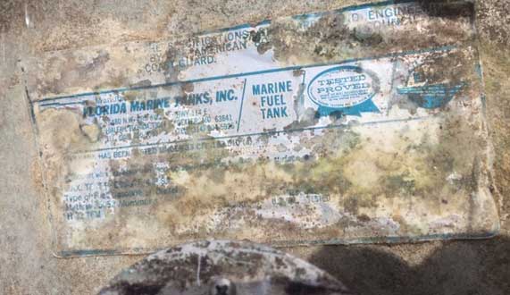

The original fuel tank, as originally installed by Boston Whaler, after 33-years in use in saltwater:
Fig. 14. Tank with foam surround and aluminum hold down bars at age 33-years.
Fig. 15. Fuel pick-up fitting.
Fig. 16. Florida Marine Tank label.

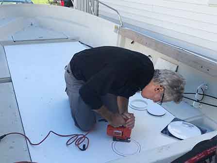

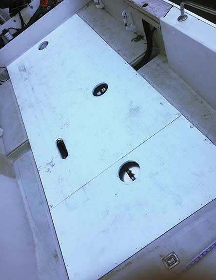

Fig. 17. Here I am cutting access holes in the new deck. The PVC material will rapidly dull the saw blade.
Fig. 18. The finished new deck in place.

I am very surprised by the new deck seen in Figure 18. I thought you were going to reinforce the original deck with the PVC. Now it looks like you discarded the original deck section and just have a flat PVC sheet as the cockpit deck.
Q5: What happened to the original deck?
Q6: If the next step is to re-wire, does that mean you are done with the deck?
Q7: Have you made any tests of the new deck's flat surface with regard to traction when wet?
Q8: What was illustrated in Figure 10?
Q9: As seen in Figure 18, there appears to be enormous contrast in the color of the new deck to the original deck of the boat's cockpit. Is the photo representative of the two colors now seen in the boat deck?

jimh wrote:Q5: What happened to the original deck?
{The original deck was] tossed. It was a rotting nasty hulk. I wanted [the deck] to be rot proof
jimh wrote:Q6: If the next step is to re-wire, does that mean you are done with the deck?
Yes.
jimh wrote:Q7: Have you made any tests of the new deck's flat surface with regard to traction when wet?
The top surface of the raw PVC is textured with an embossed faux wood grain, so it has good grip. I did test it with boat shoes and bare feet when wet and it has the same grip as the textured original Boston Whaler deck, if not better
jimh wrote:Q8: What was illustrated in Figure 10?
[Figure 10 shows] a close-up of the bottom of the new deck, two layers of roving. and the router-finished edge. The new deck is also 120-lbs lighter than the old deck.
jimh wrote:Q9: As seen in Figure 18, there appears to be enormous contrast in the color of the new deck to the original deck of the boat's cockpit. Is that just a problem in the photograph or is the photo representative of the two colors now seen in the boat deck?
Yes the colors are different, I was not going for a perfect color match, but more for a better system that will last indefinitely with no rot, sagging floors, mold, and so on.
I wanted to fix the flawed Boston Whaler deck and fuel tank design, and I think this does it.
I could have stripped the rotted wood backing of the old deck and bonded the deck top skin to the PVC, but I thought [the old deck] was redundant and would just add 120-lbs of unneeded weight to the deck.
Purists could paint the PVC deck [OUTRAGE GRAY] but that was not part of my goal. I like that the new deck is different and think it makes a statement.

Q10: Again in regard to Figure 10, is the new deck made up of more than one 3/4-inch-thickness of the PVC sheet material?
It looks like perhaps two sheets were used, with the upper sheet the full size and the second sheet somewhat smaller.
ASIDE: David--you have more gray hair than I expected to see.

jimh wrote:Q10: Again in regard to Figure 10, is the new deck made up of more than one 3/4-inch-thickness of the PVC sheet material?
Ha! Three kids will do that to your hair. The deck is one piece of 3/4 inch thick PVC that i router-ed a 2-inch flange around the perimeter so that it would fit into the in hull depression exactly

biggiefl wrote: I would have used a modern coring...like DIVINYCELL.....
I looked at DIVINYCELL H and actually tried it on a portion of my earlier bass boat renovation. DIVINYCELL H worked well in a small area, but over an entire deck I worried that it would be very expensive, too brittle, and might crack under stress.
The PVC sheet is strong yet a bit flexible and the Total Boat 2:1 resin system is also designed to have flex for use in large deck areas. I was also able to use the PVC sheet as an entire deck system without the old deck skin. Everyone has different goals--all good.

PVC sheets are the most common and age-old option [for replacing the deck].
Q11: are any other decorative and long-lasting materials available?
davidvee
Posts: 26
Joined: Wed Oct 16, 2019 10:56 am
Re: 1986 OUTRAGE 18 Replace Deck with PVC Sheet; New Fuel Tank
Postby davidvee » Wed Oct 30, 2019 9:53 am
RichardCollinge wrote:Q11: are any other decorative and long-lasting materials available?
I looked at every option and i think PVC sheet is the best. as long as the PVC sheet is reinforced with fiberglass in the right way, i.e., two layers of roving with a pattern of holes filled with thickened resin; this deck will last indefinitely, no rot, super strong, good flex, half the weight of the marine plywood original deck, not to mention inexpensive compared to KING StarBoard or DIVINYCELL. Combine that with a no-foam fuel tank installation and the basic design flaws of the original system are fixed.
if the embossed pattern and color of the deck are a problem, maybe painting the deck with Desert Tan will suffice or laminate the PVC deck to the original deck skin after removing the plywood backing. But. as I said, I think that is redundant and adds to the weight of the deck for only aesthetic reasons.

I do not have a total overall view of the fuel tank on my Boston Whaler boat that shows the entire tank, as the image at Figure 14 above shows for David's fuel tank, but I do have this view of the tank as seen at the fuel filler connection access port:
Fig. 20. Fuel tank seen at fuel filler access port on 1990 Boston Whaler boat with about 1,200-hours of running time on its engines.
As can be seen, the fuel tank retains its original green anti-corrosion paint, and there are no signs of rot, rust, or mildew. The tank appears in a similar manner at the other two access plates: at the tank level gauge and at the fuel pickup hoses. This boat was made in 1990. The photo was taken in 2014, when the access hatch plate was being replaced. The boat was 24-years old at that time. At this moment, 2019, the boat is now 29-years old and the fuel tank appearance remains as shown in Figure 20, above.
Although there are Boston Whaler boats of similar age whose fuel tanks have decayed, I believe the condition of a fuel tank at advanced ages of 25-years-old or older will likely be more related to prior care and prior use of the boat than to inherent and unavoidable mistakes in the design of the boat.

Finally Done
Postby davidvee » Mon Nov 23, 2020 2:25 pm
[The restoration of the 1986 OUTRAGE 18 is finally done.]
At Waquoit Bay October 2020.
The new laminated fiberglass and PVC sheet deck is very stiff and strong, even after a shakedown season of many long trips to Martha's Vineyard, Boston, Narragansett, and other ports.
The new fuel tank was installed without foam. and that is is working great. A separate bilge pump keeps [the fuel tank cavity] clean and dry.
The trailer has new wheels, bunks, rotors, and hitch coupler
The leaning post will be put back in place in Spring 2021 after reupholstering.
I replaced the bow rail and console rail screws with stainless steel rivets using a technique I found here on continuousWave--worked great.
The engine was just winterized with new gear oil and five quarts of engine lubricating oil. A new fuel-water separating filter and new oil filter were installed . I ran the engine on a small external tank with Yamalube fogging oil to get the injectors coated.
Thanks for all the help and will see you in Spring 2021--David
