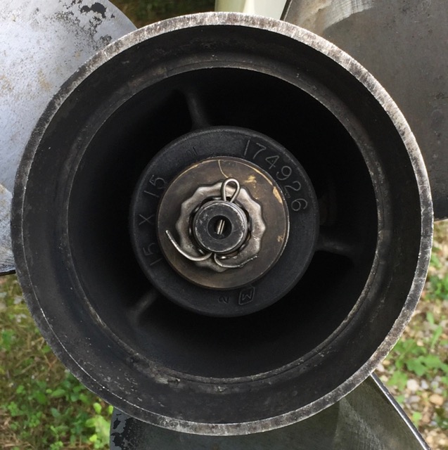

glen1941 wrote:The dealer found the propeller designation on the thrust washer: 13-7/8-diameter and 17-pitch. [This propeller has the] same [dimensions as the] old VIPER [that was on the MONTAUK 17].
That is very odd. The thrust washer is not a part of the propeller. The same thrust washer would be used with all propellers.The thrust washer is located on the propeller shaft ahead of the propeller, and it is designed to transmit the thrust force onto the propeller shaft.
More likely the dealer found the markings on the propeller but hidden under a washer or spacer that is under the propeller retainer nut.
Fig. 1. A view of a propeller with the embossed diameter, pitch, and part numbers visible under the retainer nut, washer and spacer. On a smaller propeller a spacer or washer could be large enough to obscure those markings, or there could be a build up of soot from the exhaust that obscures the numbers.

Your description of the component on which you can see the propeller dimensions as "the thrust washer" is probably not accurate. A thrust washer is the first element placed onto the propeller shaft during installation of a propeller. The propeller hub completely conceals the thrust washer. There is no way to see the thrust washer when the propeller is in place on the drive shaft.
To allow readers to better understand where you are seeing the propeller dimensions inscribed on some component of the propeller assembly, please show a photograph of the inscription that you and the dealer's technician can see while the propeller is installed on the engine propeller shaft.
I don't understand your suspicions that the propeller dimensions you are seeing are somehow NOT the proper dimensions for the propeller. There is no normal practice in which some element of the propeller assembly other than the propeller itself would be marked with the propeller dimension,

Postby glen1941 » Thu Jun 11, 2026 3:47 pm
Jim--who said that you don't have a sense of humor.
[I] will [conduct some performance tests in] some quiet water, [set the throttle to allow the engine to accelerate to] 4000-RPM, trim [the engine] to sweet spot, let a friend take the wheel, and go back to take photos of the A-V plate in the boat wake.
I hope [performing the steps listed above] will answer that my goals have mostly been met. Maximum [possible] boat speed is not a priority; it is only an indication of overall boat performance. My real goal is a solid cruise at 4000-RPM at a boat speed of about 25-MPH.
ASIDE
I was reminded after the most recent (and only my third) trip that the E-TEC engine does not use [much] fuel. [My observations were] not analytical, just that after a half-hour-long [or longer] cruise, the [fuel tank level gauge] needle barely got off the peg from FULL on a 6-gallon fuel tank.
In a week I will have more [performance and fuel consumption data]
Thanks, Glen
